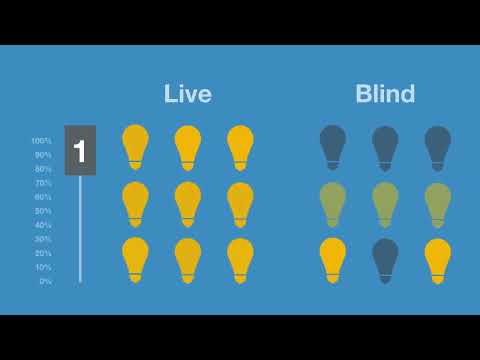

Blind mode can be used to allow you to control fixtures in ZerOS, however not send those changes to the fixtures. You are therefore controlling your fixtures "blind". Blind mode is not available on FLX S consoles.
To go into Blind mode, either tap Blind at the top of the Output Window, or on FLX hold Shift and tap Z.
Take a look at the quick video for an introduction.
The Output Window and Command Bar turn grey, and the Z key will flash, to indicate blind mode is active.
Programming in Blind Mode
Changing intensities and fixture parameters within blind mode is exactly the same as normal operation, except it won’t change the lighting state on stage. It is therefore especially useful to allow you to record new cues in blind without the audience knowing, and then play them back live once recorded.
To record a cue in blind, create a lighting state using the fixture controls in the normal way. The lighting state can then be recorded to a fader by tapping Record, followed by tapping a playback's button.
Playback in Blind Mode
Programmed playbacks can be raised whilst in Blind mode and the recorded lighting state will then output live. This functionality is the same for both playbacks that have been recorded in Blind mode and playbacks that have been recorded Live (playbacks that have been recorded normally whilst not in Blind mode).
Pressing GO on a playback will continue to work like normal, even though blind mode is active.
When in Blind, playback faders can be raised and playback GO buttons can be pressed, and the programmed cues will still output live. Blind therefore doesn't simply freeze the DMX output, but instead allows fixtures to be adjusted manually without the audience knowing.
