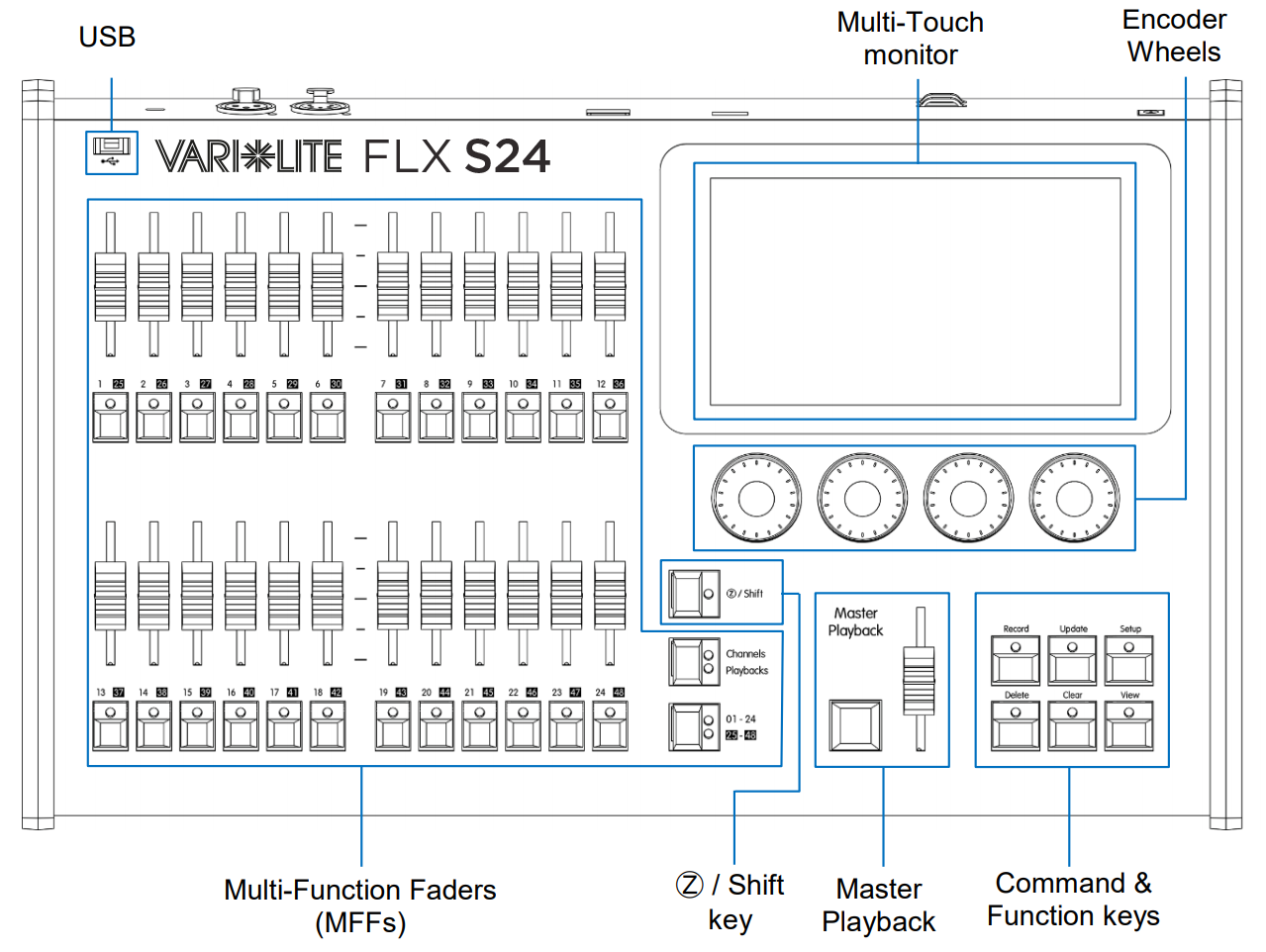

Multi-Function Faders (MFFs)
FLX S24 consoles are equipped with 24 Multi-Function Faders. These can quickly and easily be switched between their two functions (“Channels” and “Playbacks”) by using the Fader Funct. button.
Channels
When set to “Channels”, the faders directly control each light (or “fixture”) in the rig. Each fixture, no matter what it is, will have a single “Channel Number”, and so will take up a single channel fader. FLX S24 has two pages of channel faders, and can therefore control a maximum of 96 fixtures. The Page button can be used to switch the faders between fixtures (see below).
Playbacks (or cues, stacks, submasters or chases)
Lighting “states” (or “scenes”) can be pre-recorded, ready to be recalled later. They are called “cues”, and are recorded onto “playbacks”. Each playback can store a single cue, or multiple cues. FLX S24 consoles support 96 playbacks, plus the “Master Playback”. Traditionally, playbacks with a single cue have often been referred to as “submasters” whereas playbacks with multiple cues have often been referred to as “cue stacks”. We simply call them all playbacks.
Page
On FLX S24, the page button allows you to switch between faders 1 – 24 and faders 25 – 48. Switching between “Channels” and “Playbacks” will automatically change the page to the page you had previously selected when in that function.
Master Playback
For many shows, especially theatrical, a single playback is often used with a long list of pre-recorded cues. For these situations, an additional “Master Playback” is provided.
Function keys
Function keys either perform functions themselves (like View), or change the functionality of other buttons when pressed at the same time (like Setupand Shift).
Command Keys
Command keys are used during programming to access commands such as Record, Updateand Delete.
Encoder wheels
Four encoder wheels are provided and used for accurate control of various settings. The settings currently being controlled by the four encoders are displayed in the four boxes along the bottom of the touch screen, just above the encoders. The button in the middle of each encoder is occasionally used to perform an additional, but related, task.
Z / Shift key
The Z Key places a range of quick access settings & functions on the internal display and encoder wheels. On FLX S24, holding Z acts as “Shift”, changing the functionality of other buttons when pressed simultaneously.
USB port
FLX S24 consoles include a USB 2.0 port on the front panel, and one other USB port on the rear of the console. USB ports can be used for: Keyboard, External Storage Devices (such as Memory Sticks), ZerOS Wings.
